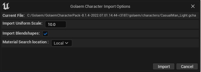

Character Import UI
When importing a gcha, the character materials will be search and linked automatically if they have the same name and are found in :
  • Local : in the same folder as import path
  • Under Parent : in the parent folder of the current import path
  • Under Root : under the root folder of the scene / level
  • All Assets : name will be search in all loaded assets of the current level (note that materials present in the content folder, but not yet loaded in the level, may be skipped)
  • Do Not Search : default materials will be created as place holders
