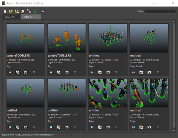

Once the simulation is done, open the Simulation Exporter to export the Simulation Cache.
Once the Simulation Cache will be exported, a Simulation Cache Library File (.gscb) will be created in the same directory than the Simulation Cache.
It is also possible to add the exported simulation to an existing Simulation Cache Library File using the Library Tool.
The Simulation Cache Library File contains the useful information about exported simulations such as the export directory, the Character Files used...

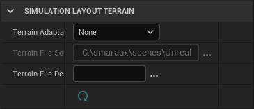

If you want to snap your simulated cache to a different terrain, as the one the cache is imported from, and if a source terrain exists for this cache, you can use the Simulation Layout Terrain for adaptation.

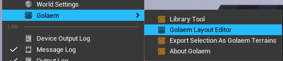

A terrain can be exported from Unreal objects, such as Meshes and Landscapes, via the "Export Selection As Golaem Terrain" found in the Window/Golaem menu. It will produce a gtg file which is the relevent format to provide a terrain to the simulation cache.
Once this is done, you can add this terrain as the destination terrain in the Golaem Cache node attributes, under Simulation Layout Terrain section

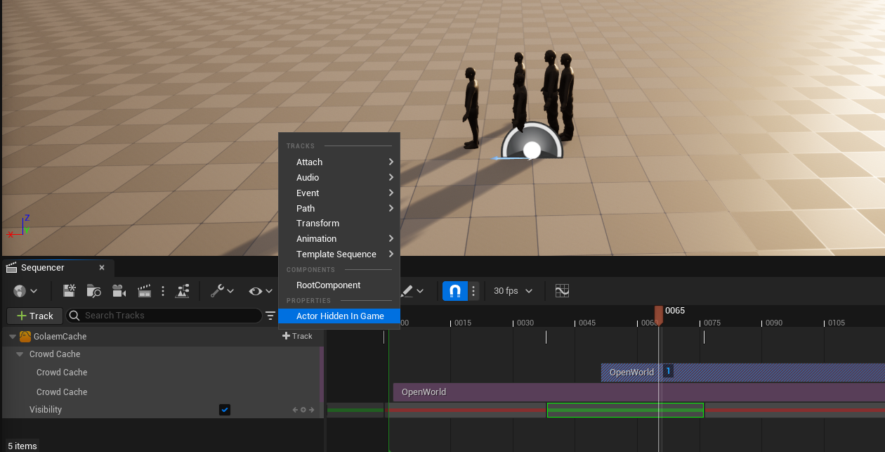

The common way to render a Golaem Cache is by using the sequencer :
  • Add a track "Actor To Sequencer" for the GolaemCache Node.
  • On this Golaem Cache track, press the [+Track] button, and add an animation > Golaem Cache Track
  • You can also control the cache visibility, by pressing the Golaem Cache [+Track] button, and select "Actor Hidden In Game", which will add a keyframe-able visibility track.
The Golaem Cache Track can be time-edited, duplicated, cropped, etc.
