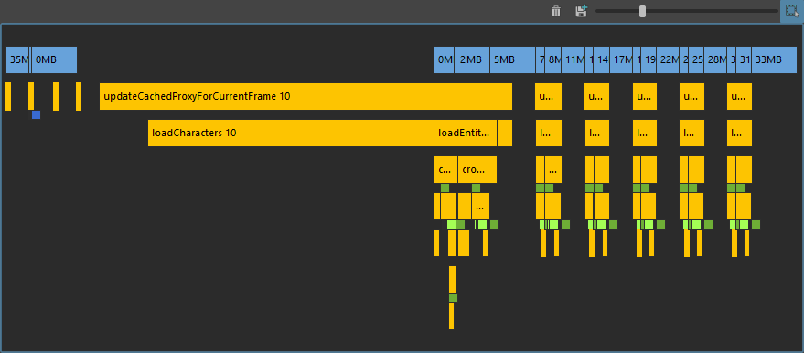

Except for the memory events, all events in the timeline are displayed in what is called a "call stack". It simply means that the way events are displayed tells if an event is part of an other or not.
For instance, here is a typical call stack that can be displayed on the timeline:
A callstack in the Performance Timeline
Which can be described as follows:
- the updateCachedProxyFor... function is called
- which calls for the loadEntities function
- which calls the crowdField1 computations
- creating a frame data with layout modifications
) to
store the result of the layout - calling for the glmCreateModifiedFrameData function to compute
the layout
- calling another unnamed function
- and again calling another unnamed function
- loadEntities also calls the crowdField2 computations after the
crowdField1 computations are done
) to
the layout
) - creating a source frame data
) - calling readFrameData function to load the frame from disk
- calling layoutTransformations to compute the layout
transformations
- calling each node in the layout file one after the other, but each individual node can't be seen here because it takes too little time

This call stack display lets you find generic information by looking
only at the upper part of the call stack (for instance, the update of
the cache proxy took 14.9ms:
), or very
detailed information by looking at the lower part of the call stack
(the time spent in the update of the cache proxy is composed of 3.7ms
for the crowdField1
and 11.2ms for the crowdField2
