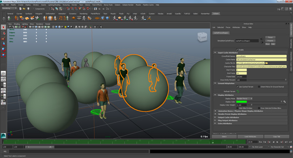

Previsualization of an exported Simulation Cache using the Simulation Cache Proxy.

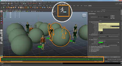

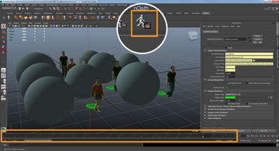

There are several ways to check which mode Golaem is in: looking at the Shelf icon and at the Maya timeline:
Difference between Simulation Mode (left) and Cache Replay Mode (right)

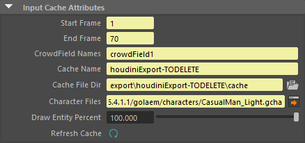

Input Cache Attributes
CrowdField Names Name of the Crowd Fields to import. Separate the names with ;
Cache Name Name of the Simulation Cache to import
Cache File Dir Directory from where the Simulation Cache files will be imported
Character Files File path to the Golaem Character File (.gcha). Open the Character Files in the Character Maker by clicking on
Start Frame First frame to import
End Frame Last frame to import
Draw Entity percent Only draw a given percent of entities to save display time.
Refresh Cache Reload the Simulation Cache from their respective files. Also available from the Simulation Cache Proxy Shelf Contextual Menu / right click / Reload Proxy Caches

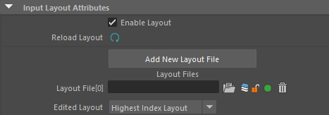

Input Layout Attributes
Enable Layout If checked, the result of the deformation layers contained in the specified Layout files will be displayed in the viewport for this node.
Refresh Layout Reload all the Layouts from their respective file, and apply them to the node. Beware that unsaved modifications will be lost. Also available from the Simulation Cache Proxy Shelf Contextual Menu / right click / Reload Proxy Layouts
Layout File
Stack of the Layout files (.gscl) to apply to this node. The applied Layout files can be changed using the Simulation Cache Layout Tool. Lower indices are applied first. This stack can be used to handle different retakes, or different edition proposals based on a same master edition etc.
Add New Layout File: Adds a new Layout File in the stack, with a higher index than existing ones (Maya logical index), or 0 if stack is empty
 Open a layout file
 Open this layout in the Simulation Cache Layout
 Lock / unlock the edition of this layout level

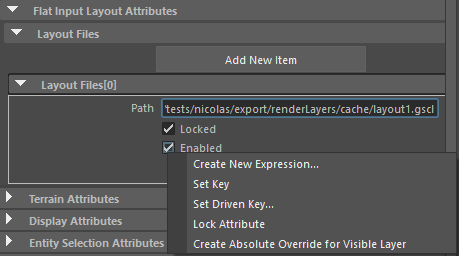

 Enable / disable this layout level (if disabled, behaves like a pass through). This attribute can be keyframed by setting a key on the layoutFiles[idOfTheLayout].enabled attribute of the Simulation Cache Proxy node (e.g. MEL: setKeyframe { "cacheProxyShape1.layoutFiles[0].enabled" };). Please notice that for the node needs to be reselected to update its Attribute Editor correctly when keyframed. This will also be applied at rendering time.
 Delete this layout file from the stack (does NOT delete the file itself)
Edited Layout Choose in the drop-box the layout to edit when transforming cached entities in Maya. Defaults to "highest layout index", meaning that the edition will stack on the last layout applied. If the chosen layout is locked, the editing (live or via the nodal editor) will be frozen and read only.
Flat Input Layout Attributes
Those attributes replicate the same attributes as above but with a vanilla Maya template, making it easier to create Render Layer overrides.

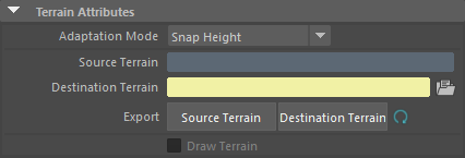

Terrain Attributes
By default, those attributes are connected to the Simulation Cache Proxy Manager attributes.
Adaptation Mode
Default terrain adaptation mode which is applied to the cached Entities. The available modes are:
  • None: Entities will not be adapted on the new ground, they will keep their original height
  • Snap Height (default): Entities will be snapped on the new ground's height (the pelvis to ground distance will be preserved, but feet might not be on the ground)
  • Snap Height And Ori: Entities will be snapped on the new ground's height, and their orientations will change to match the ground's normal
  • With IK: entity will be ground adapted by using IKs on each of their legs (the original foot-to-ground distance will be kept for each foot)
Notice that this mode can be changed on a per-character basis using the Ground Adaptation Layer of the Layout Editor.
Finally this data is stored in the associated Layout File. Make sure to save the Layout File at each change to take it into account in the viewport and at render time
Source Terrain File path to the terrain geometry stored in the Terrain Locator and which has been used to create the Simulation Cache Files. The Terrain geometry file is automatically exported the first time a simulation is exported in a new directory. This file can be updated for this node using the Export Source Terrain below or for all nodes using the button in the Simulation Cache Proxy Manager
Destination Terrain File path to the terrain geometry on which the Entities will be adapted when using the Simulation Cache Layout Tool. If none is specified, Entities will be adapted to the Source Terrain file. This file can be updated for this node using the Export Destination Terrain below or for all nodes using the button in the Simulation Cache Proxy Manager
Export Source Terrain Exports the Maya geometry meshes used in the simulation as a Source Terrain file. As it exports the meshes connected to the Terrain Locator used by the Crowd Fields on this node, it only works if the simulation is in the same scene. The Terrain is automatically exported in the same directory than the Simulation Cache Files of the node
Export Destination Terrain Exports the currently selected Maya geometry meshes as a Destination Terrain file. The new Terrain File will be used to adapt the edited Entities on. The Terrain is automatically exported in the same directory than the Simulation Cache Files of the node.
Refresh Terrain Flush the Terrain cache used for adaptation and reload it. Also available from the Simulation Cache Proxy Shelf Contextual Menu / right click / Reload Proxy Terrains

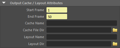

Output Cache / Layout Attributes
These attributes are used when a the deformations of a Simulation Cache Layout are baked down to a new Simulation Cache:
Start Frame First frame to export
End Frame Last frame to export
Cache Name Name of the new Simulation Cache files
Cache File Dir Directory where the new Simulation Cache files will be exported (must be different than the one specified in the Input Cache Attributes)
Layout Name Name of the new Simulation Cache Layout file
Layout Dir Directory where the new Simulation Cache Layout file will be exported

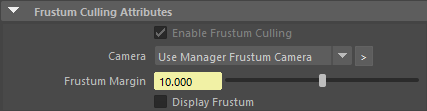

Frustum Culling Attributes
The Cache proxy entities can be culled based on a camera frustum. By default, this camera is the one defined in the Crowd Manager Simulation Render Attributes. The enable & frustum margin attributes are linked to this Crowd Manager section by default, but the connections can be broken to get a custom frustum for a specific cache proxy. Note that the Cache Proxy frustum as a frustum margin, but no camera margin (the cylinder around the camera).
Enable Frustum Culling Is the frustum culling enabled, based on below camera
Camera The camera to use (defaults to 'use manager frustum camera')
Frustum Margin The margin around the frustum where entities are still kept
Display Frustum Displays the frustum volume. This is not linked to the Crowd Manager  by default, to avoid rendering multiple times the same frustum.
