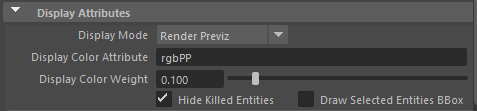

Display Attributes
| Display Mode | See here. |
| Display Color Attribute | The PP attribute containing the display color. The default is rgbPP. This attribute must be exported in the Simulation Cache Exporter |
| Display Color Weight | See here. |
| Hide Killed Entities | Do not display the entities in the kill list. |
| Draw Selected Entities BBox | Draw the geometry bounding box around the selected entities |
