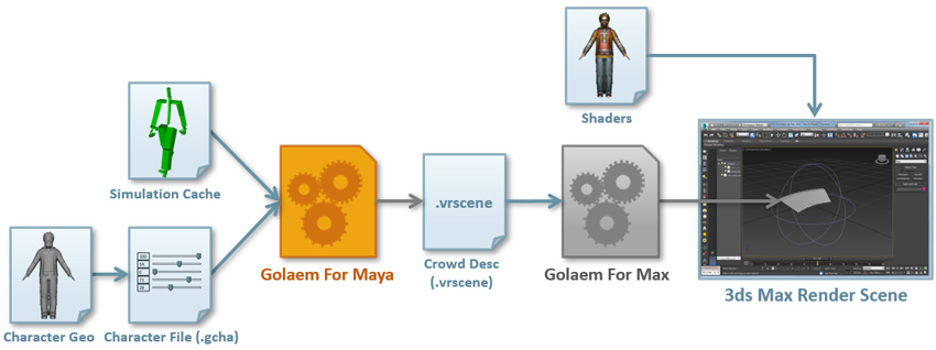

The figure below details the workflow of the render of Golaem simulations with V-Ray in 3ds Max. For a better understanding of the process, check the Golaem Rendering Workflow.
Setup Simulation in Maya
Create your Crowd Simulation within Maya using Golaem. In our example we will use the stadium scene from the Golaem Samples. Once the simulation is done, open the Simulation Exporter to export the Simulation Cache and import the Crowd Shaders in your Maya scene. Once the Simulation Cache will be exported, a Simulation Cache Proxy and a Crowd Render Proxy node will be created and Golaem will be switched in Cache Replay Mode. .

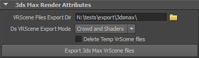

The Crowd Render Proxy node defines attributes to export custom .vrscene files for 3ds Max (in the VRay Attributes):
Specify the directory in which you'd like the files to be exported and press the "Export 3ds Max VrScene files" button. You'll get two files:
  • cacheName.proxyNodeName.vrscene which defines how V-Ray should handle the exported Simulation Caches and render them as Crowd Characters (e.g. all the parameters defined in the VRay Render Proxy). Details about this .vrscene file can be found here.
  • cacheName.proxyNodeName_shaders.vrscene which contains the shaders used by the exported Crowd Entities.

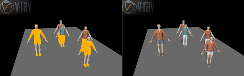

Caution:
To export the shaders used by the exported Crowd Entities within Maya, the proxy uses VRay's built-in vrscene exporter. If you're using the free Demo version of V-Ray for Maya, keep in mind that only the shaders of the first 200 objects of your scene will be exported as a .vrscene. The exported shaders can be checked when doing a render in Maya. If some Crowd Character meshes appear orange, it means that there are too many objects in the scene. Delete them to export the shaders properly.

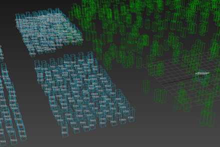

Left: more than 200 objects in the scene - Right: less than 200 objects in the scene

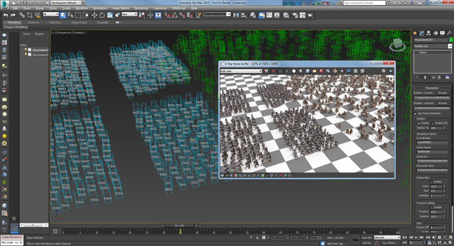

Rendering a Simulation in 3ds Max with V-Ray

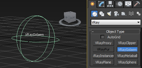

A VRayGolaem node is a 3ds Max proxy object which references a crowd .vrscene file and a shader .vrscene file and handles the rendering of a Golaem Crowd simulation in 3ds Max at render time. It can be created from the Create tab of the Command panel, VRay category, select the VRayGolaem button in the Object Type panel, and then click and drag in a viewport to create it.
Caution:
Instancing a VRayGolaem node is not supported.
The node has two attributes to load the Crowd and the Shader .vrscene files (optional). You can specify Texture search paths using the VRAY_ASSETS_PATH environment variable if needed.
Once the Crowd .vrscene file loaded, the other attributes of the node will be automatically filled according to the content of the file. They now can be edited to change the rendering results (motion blur properties, subdivision attributes...). The 3ds Max node attributes are the same as the Maya node.
Those parameters will also enable to display the Crowd Entities as bounding boxes within 3ds Max viewport (notice that frames 0 and 1 are not exported and nothing will be displayed for those) :

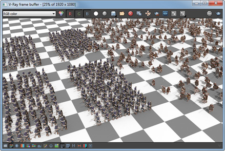

When you're happy with everything, render with V-Ray and you're done!
Notice that this method has the same properties than rendering inside of Maya. It means that it supports 3d motion blur, displacement, frustum culling, subdivision surfaces, shading variation, render passes... More here. The only not supported feature in 3ds Max is light linking.

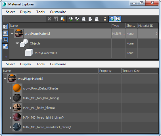

Assigning 3ds Max Shaders
By default, the shaders used by the VRayGolaem node for the Crowd Entities are exported from Maya in a .vrscene file and loaded in the Shaders .vrscene attribute. Those shaders can be directly created in 3ds Max.
Caution:
For performance reasons, only 3ds Max Shaders assigned to the VRay Golaem node (as Multi/Sub-Object shaders) will be available to Crowd Characters.
Assign a Multi/Sub-Object material to the VRayGolaem node and create as Sub-Objects as you need. For each of those Sub-Object create a Shader from the V-Ray Materials library (Standard 3ds Max shaders are not supported) and rename it according to name of the Shaders stored the Character File postfixed with a "@" (see image below). At render time, those shaders will be updated and made available to Crowd Entities:
If a Shader listed in the Character File, with the same name, is found both in the Shader .vrscene file and in the VRayGolaem Sub-Objects, the one in the .vrscene file will be used in priority. To fix this, you can either remove the Shader .vrscene file from the proxy node or reexport the Shader .vrscene file from Maya after having deleted the Shader node from your Maya scene.
If a Shader listed in the Character File, with the same name, is not found (neither in the Shader .vrscene file nor in the VRayGolaem Sub-Objects), the default shader is used (the name of the default shader can be found / changed in the VRayGolaem node attributes). If the default shader is not found, the meshes requiring that Shader are not rendered.

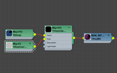

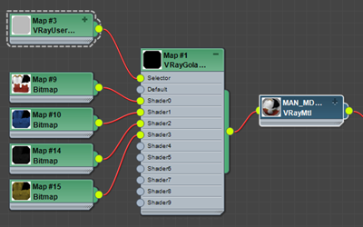

Dealing with Shading Variation
Golaem lets you define Shader Attributes in the Character Maker which can be then used to pass random or PP Attribute controlled values to the shading graph. Those values can also be read and used in 3ds Max using the VRay's VRayUserScalar shader. Golaem also provides two VRay maps shaders called VRayGolaemSwitch and VRayGolaemHSL which can respectively be used to make texture variation and color variation. Those maps shaders work the same way as the Maya ones:
VRayGolaemSwitch and VRayGolaemHSL maps in the Slate Material Editor

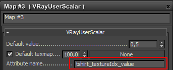

Texture Variation
Thus, if an integer Shader Attribute called tshirt_textureIdx_value with a value between 0 and 3 has been defined on the Tshirt mesh in the Character Maker, a VRayUserScalar shader can be created and set with the same name:
This VRayUserScalar shader can then be plugged wherever you want on the Shading Graph of the Tshirt mesh (which should be linked to the VRay Golaem Multi/Sub-Object shader), such as a VRayGolaemSwitch for example:

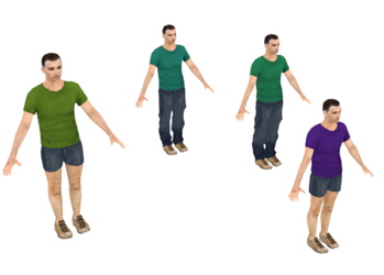

Example of a Texture Variation

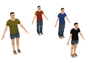

Color Variation

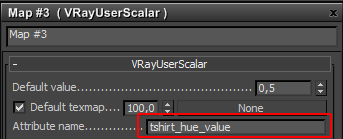

Thus, if a float Shader Attribute called tshirt_hue_value with a value between -1. and 1. has been defined on the Tshirt mesh in the Character Maker, a VRayUserScalar shader can be created and set with the same name:
This VRayUserScalar shader can then be plugged wherever you want on the Shading Graph of the Tshirt mesh (which should be linked to the VRay Golaem Multi/Sub-Object shader), such as a VRayGolaemHSL saturation attribute for example:
Example of a Color Variation
Texture and Color variation can be combined in any ways and a same VRayUserScalar shader can also be used to feed different attributes within the same shading graph.

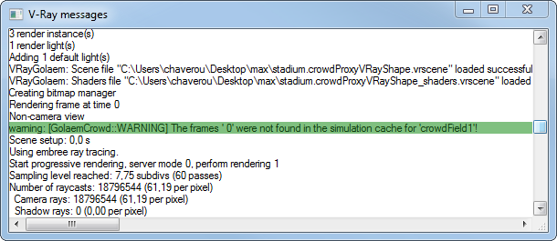

  • If something fails (procedural not found, missing shaders, missing cache file...), V-Ray and/or Golaem will almost always warn you in the V-Ray messages window. A more verbose render log can be found in %TEMP%/vraylog.txt
