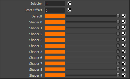

Configuration
Selector Value determining which input will be used. It is usually linked to a value which changes for each character (e.g. V-Ray User Scalar), hence creating the diversity
Start Offset Value substracted from the selector value when choosing the shader. It is used to create chains of Switch Shaders when more than 10 inputs are needed
Default Default shader to use if no shader corresponds to the Selector value
Shader 0 to 9 Input shaders/textures slots corresponding to the Selector value (e.g. if Selector value is 0, Shader 0 will be returned as output)
