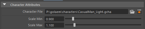

Character File (.gcha file) File describing the Character. It can be made using the Character Maker and contains information about the Animation Skeleton, Dynamics Shapes and Geometry... Open the Character File in the Character Maker by clicking on
Scale Min The lower scale bound
Scale Max The upper scale bound

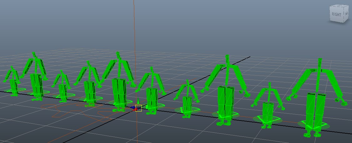

*Illustration of the use of scaled (0.5 to 1.0) Entity Types during the placement step (see the Population Tool) *

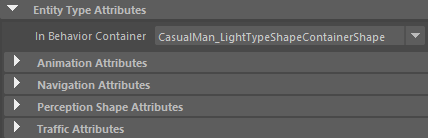

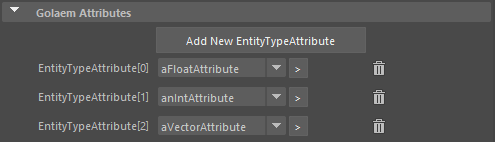

This section lists all the Entity Type Attributes attached to this Entity Type and lets you add new ones or to remove existing ones.
In Behavior Container Behavior Container attached to this Entity Type. A Behavior Container is automatically created with an Entity Type. Open the mapped Behavior Container in the Behavior Editor by clicking on
In Dynamic Attributes The Dynamic Attributes associated with the Entity Type. See Entity Type Attribute

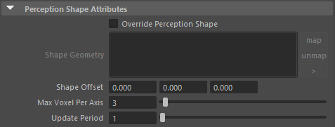

The Perception Shape is voxelized and the voxels that approximate it are what the Sensors can detect. The amount of voxels is defined by adjusting the Max Voxel Per Axis parameter. The voxels that approximate the Perception Shape are also used in the Navigation and Go To behaviors. To visualize the voxels during the simulation, enable Display Entities on the Perception Locator.
Override Perception Shape When checked, it overrides the default Perception Shape defined in the Character Maker Skeleton Tab, using a custom Perception Shape (see Perception Geometry).
Shape Geometry The geometry that defines the volume of the entity in the perception system. The scale of the entity is applied to the Perception Shape. Only available if Override Perception Shape is checked. More than one mesh can be mapped, but each mesh must be convex, closed and have its normals point outwards.
Shape Offset The vector by which to offset the Perception Shape relative to the entity position.
Max Voxel Per Axis
Maximum voxel count along each axis. The voxel computation will choose the voxel count within the given limit that best matches the perception shape.
The greater the voxel count, the closer the voxels can approximate the Perception Shape, at the expense of performance.
Update Period The period in frames to update the perception shape according to the position and orientation of the entity.

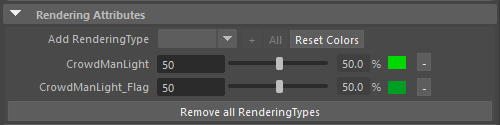

Add Rendering Type List of the Rendering Types available to add to this Entity Type. and their weights (to be able to assign Rendering Types, you must create some in the Geometry part of the Character File).
  • +: add the selected Rendering Type
  • All: add all the available Rendering Types
  • Reset Colors: reset the colors of all the selected Rendering Types. The computed colors are variations of the Entity Type Display Color, the color of the first Rendering Type is set to the Display Color.
(Rendering Types list) List of the selected Rendering Types, their weights and their colors.
  • -: remove the selected Rendering Type
Remove all Rendering Types Remove all the Rendering Types from the Entity Type

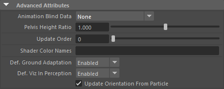

Animation Blind Data
  • None: animation blind data won't be used
  • Unmapped joints only: animation blind data will be used only on parts of the skeleton that are not mapped in the .gcha file
  • All: animation blind data will override animation even on parts of the skeleton that are mapped in the .gcha file
See here for more information about animation blind data.
Pelvis Height Ratio The Root Height is a value corresponding to the height delta between the pelvis and the lowest bone extremity. A value of 0 will make the skeleton pelvis at the same height of the particle.
Update Order When using MasterSlave behavior, the master EntityType should be updated before the slave, so that master has been updated when slaves binds to it. To achieve this, assign lower the Update Order to a master EntityType, and its update will occur sooner in the update process. To make it short, in simple cases, you can assign 0 to the master EntityType, and 1 the the slave EntityType.
Shader Color Attribute Names The name of the shader output color. This name is used to retrieve a diffuse color or a diffuse texture for the "Render Previz" mode.If no shader output plug color is provided, a list of standard names is used. This list contains: diffuseColor, diffuse, diffuseTex, color, tipColor, waterColor, selectedColor, viewportColor
Def. Ground Adaptation The default ground adaptation policy for this EntityType. This setting will act sooner than using a groundAdapt, to choose from start if an entity must be mapped to ground, avoiding sticking an entity to an unwanted ground at first frame.
Def. Viz In Perception The default perception visibility policy for this EntityType. This setting lets you disable the visibility of an EntityType so it will not be avoided when using a Navigation Behavior. It will not be feeled by Sensors anymore.
