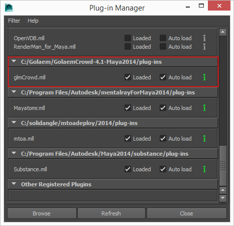

I cannot find the glmCrowd line in the Plug-in Manager
In order to be loaded by Maya, and then listed in the Plug-in Manager, Golaem Crowd needs to set MAYA_MODULE_PATH environment variable.
The module path is automatically set at the install of Golaem on Windows. If the plug-in line don't show up (you may have disabled the automatic setup at the install) please set MAYA_MODULE_PATH environment variable yourself in your system.

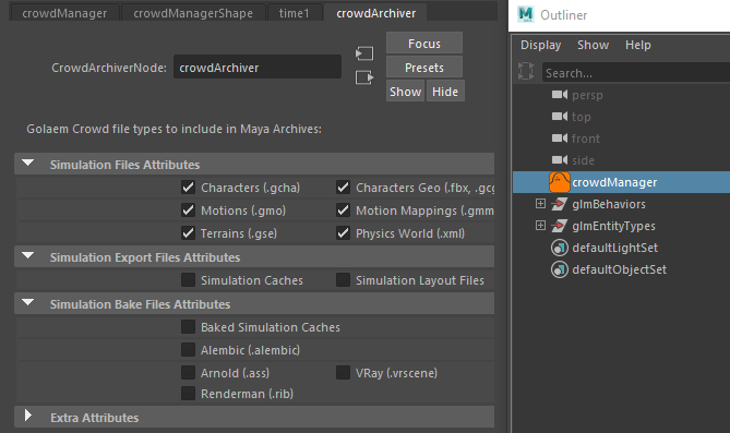

Golaem Crowds comes with the handy Crowd Archiver node which includes Golaem Crowd files in a Maya archive.
Go into your Crowd Manager attributes and click on the crowdArchiver tab to select which features you want to export:
- If you don’t want to send us your scene textures (which could generate a big file), delete your shading reference character and then go to the HyperShade and select Edit/Delete Unused Nodes before archiving your scene.
- If your problem is related to rendering or layout, do not forget to check simulation caches / simulation layout

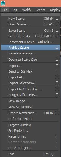

When you are ready to archive just go into the file menu and click on the Archive Scene menu to create a .zip file with all the needed file included.

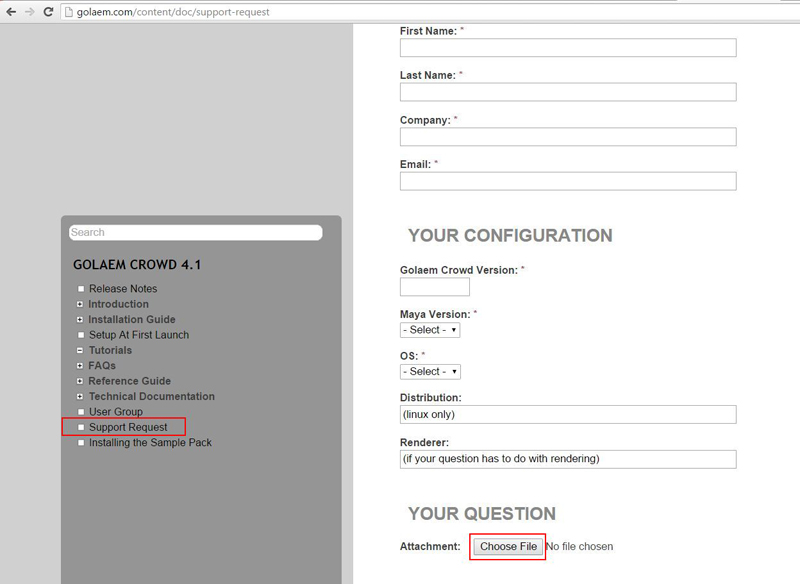

Depending on the file size, you can send it through
- our Support request page (limited to 64mo)
- on the Golaem Support email (limited to 25mo, available only to customers)
- on the crowd list (limited to 25mo, note that files sent on this list are public which may not comply with your company rules)
If the size of your archive is too big, either use wetransfer (or any other transfer service) or your FTP.
As it's possible to select the different scene assets you send us, please make sure to check the Simulation Cache checkbox if you are facing a rendering issue.

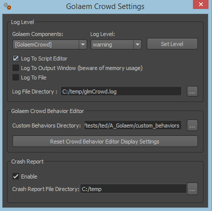

Suddenly your scene crashes and you don't know what happened. Thus, you can enable Golaem Crash report:
1.Open the Golaem Menu / Settings Menu. Enable the Crash Report and note where the Crash Report File Directory is located.
2. Reproduce the crash once again, a .dmp file will be written at the specified directory. You may now send it to your favorite support team. Dmp files contain information that only the Golaem team can read and does not store anything related to the scene.

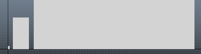

Let's illustrate Crowd Unit with a use case: consider a door object (and assume it's a regular door 1m width * 2m height).
- Left: door mesh is 1 Maya unit width * 2 Maya units height => 1 Maya unit equals 1m => Crowd Unit has to be in meters (default value)
- Middle: door mesh 10 Maya units width * 20 Maya units height => 10 Maya units equals 1m => 1 Maya unit equals 0.1m => Crowd Unit has to be in decimeters.
- Right: door mesh is 100 Maya units width * 200 Maya units height => 100 Maya units equals 1m => 1 Maya unit equals 0.01m => Crowd Unit has to be in centimeters.
- And so on and so forth...
