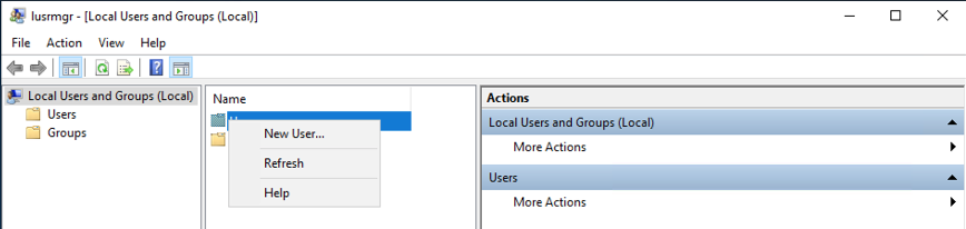

- Right-click on Users and select New User.
- Enter the user name "ggc_user" and set the password. Then click Create.
