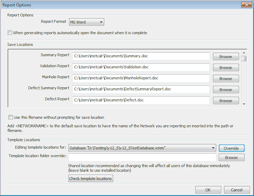

This dialog is used when Generating built-in reports to specify:
- Template to be used to generate report
- Format of generated report
- Generated report Save location
Show me
The dialog is displayed when Report options is selected from the Reports menu.
Dialog description
Section |
Description |
Report Options |
A list of format options for generated reports. Choose:
Check the box below the list to automatically open a report after it has been generated. |
Save Locations |
Lists the available built-in report types. The default path for each report type can be edited by typing in a new path name or click Browse to search for a folder. Type "<NETWORKNAME>" into the path to insert the name of the network for which the report is being generated into the save location. By default a prompt will appear when generating a report to confirm the Save Location is correct. Check Use this filename without prompting for Save Location to bypass this step. Tip:
Note that a prompt will still be displayed if the file already exists (prompt to overwrite) or if the filename cannot be used for any reason. |
Template Locations |
Specifies the path of a folder containing alternative report templates. The specified folder may be used to store customised templates to be used instead of the installed default templates. If a location is not specified, the installed report templates will be used. The template location may be specified on a per network or per database basis. The folder specified should be in a shared location for use by multiple users.
Click Check template locations to display a log listing the report templates available at the specified location, and a list of the templates that cannot be found at the template location and will therefore be used from the installed location instead. |
