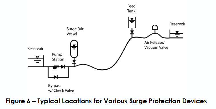

Diversionary tactics make use of various surge protection devices by which fluid is drawn into, or expelled from the piping system in order to reduce the rate of flow changes. Examples of surge protection devices are discussed in the previous section. These devices would normally be installed at or near the point where the disturbance is initiated such as at the pump discharge or by the closing valve (with the exception of Air Relief/Vacuum Breaking Valves and Feed Tanks).
Figure 6 illustrates typical locations for the various surge protection devices in a water distribution system.
