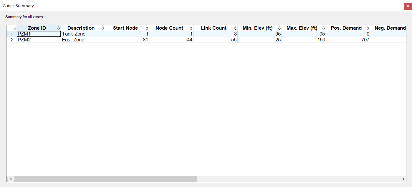

PZM Summary - Zones Summary
This screen displays a summary of the data from all current pressure zones. It is initiated by clicking PZM Summary from the Pressure Zone Results dialog box. The summary includes the Zone ID and Description, the start node used for the pressure zone trace, the node count, the link count, the minimum and maximum node elevation, total positive and negative demand total pipe length, total inflow and outflow, minimum and maximum pressure and minimum and maximum water quality data if available. Selected zone data may also be sent to a printer.
