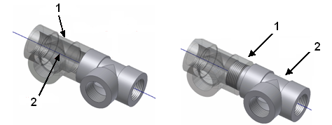

If the free fitting is being inserted between 2 connected fittings or a fitting and a pipe segment, the part must be a fitting and the fitting must have 2 connections. The connections need not be collinear. The base fittings must be 2 connected fittings or a fitting connected to a pipe segment. In this case the base fitting specifies the connection that constrains the position and routing of the fitting group. When a fitting is inserted, the base fitting (1) that controls the route point (2) does not move. The inserted fitting (1) and other adjacent fittings (2) adjust accordingly, and the pipe segment is trimmed back to accommodate the change.
