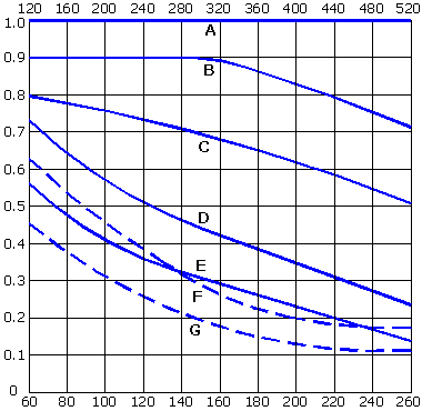

Surface Factor Cs in Bevel Gears
Reduction in endurance limit due to surface finish (steel parts).
Hardness (HB)
Tensile strength Su (ksi)
where:
A - Mirror-polished.
B - Fine-ground or commercially polished.
C - Machined or cold drawn.
D - Hot-rolled.
E - As forged.
F - Corroded in tap water.
G - Corroded in salt water.
