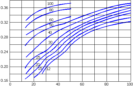

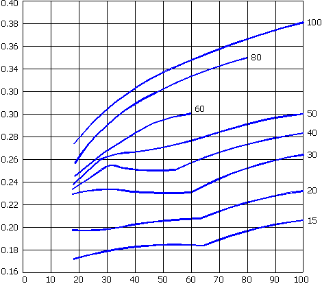

Geometry Factor J in Bevel Gears
For standard spur gears (based on tooth fillet radius = 0.35/P). From AGMA Information Sheet 225.01.
Number of teeth in gear for which geometry factor is desired
Number of teeth in mating gear.
