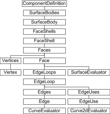

Boundary Representation (BRep) Object Model Diagram
Working with the BRep API
The BRep API has a number of hierarchical objects. The topmost is the SurfaceBodies collection of SurfaceBody objects. A SurfaceBody object represents a discrete part.
Faces enclose a volume. A Face represents any geometry; planes, cylinders, free-form surfaces, and so on. A simple example is a solid cylinder. The cylinder consists of three faces. Two planar faces that act as the ends of a cylinder and one cylindrical face that acts as the side of the cylinder.

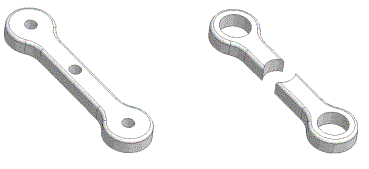

A FaceShell object represents a connected set of faces. A FaceShell for a simple cylinder has the two planar end faces, and the non-planar side face. Typically a SurfaceBody contains a single FaceShell object, but it is possible to have more, as in the following illustration:
The SurfaceBody on the left has one FaceShell. Increasing the hole diameter results in the SurfaceBody on the right, comprised of two FaceShell objects.
EdgeLoop, Edge, and EdgeUse objects
EdgeLoop objects define a face boundary. Several EdgeLoop objects can exist for a given face. The following figure highlights the four EdgeLoop objects for the top face of this solid.
An Edge object is similar but defines only the connectivity between two adjacent faces, so typically represents only part of an EdgeLoop. An Edge object is shared between faces, unlike an EdgeUse object. A face has its own set of EdgeUse objects, which apply only to that face. They are defined in terms of the 2D parameter space of that face. Typically, there are two EdgeUse objects for each Edge Object. Edge objects are shared between faces but EdgeUse objects are not. They contain information specific to a face, including a conceptual flow direction for the face edges, useful in traversing faces.
In the BRep API, a vertex indicates a connection of at least two edges. Vertices are implied by the edges in the model.
BRep objects expose the Geometry property that returns the underlying geometry of the object.

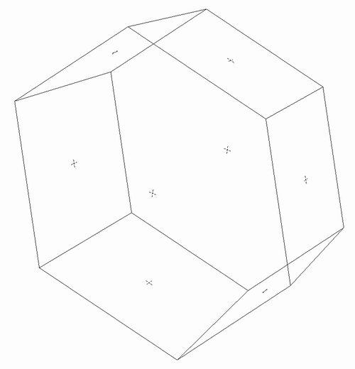

The sample places new sketches and sketch points in the part document. The sketch points are located at the center of all planar faces. For example, a tapered hexagonal solid results in placement of the following sketch points (here shown in wireframe mode):
