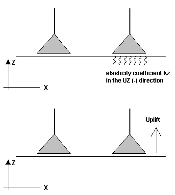

When you define an uplift for a constraint (such as, uplift based on the orientation of the Z axis, that is, UZ+), you can also determine the elastic base coefficient KZ for each constraint. The elastic base coefficient is determined only for the orientation opposite to the one defined for up-lifting (that is, for UZ-). See the following images:
