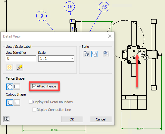

Fix Detail View
It is now very easy to fix a detail view to a point during creation. Check the newly added "Attach Fence" box in the Detail View dialog, and select a point to fix the detail view to.
For more information see To Create and Edit Detail Views.
