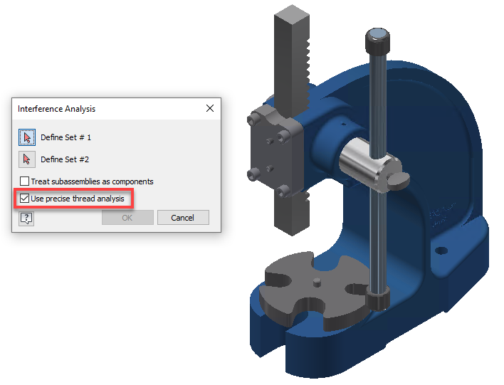

Disable the Extended Thread Depth Analysis for Interference Analysis
When you create holes with the thread feature, thread isn't always from the hole start to the hole end. That leads to interferences in the design. Now, you have an option to exclude extended thread depth analysis. Uncheck the newly added "Use precise thread analysis" box in the Interference Analysis dialog.
For more information see To Analyze Interference Among Components.

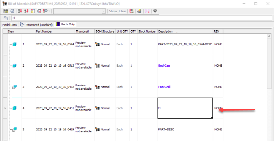

Override AnyCAD reference file iProperties in BOM
Editing iProperty information for imported models is now easier - you can override standard and custom iProperties for referenced AnyCAD files directly in the BOM.
