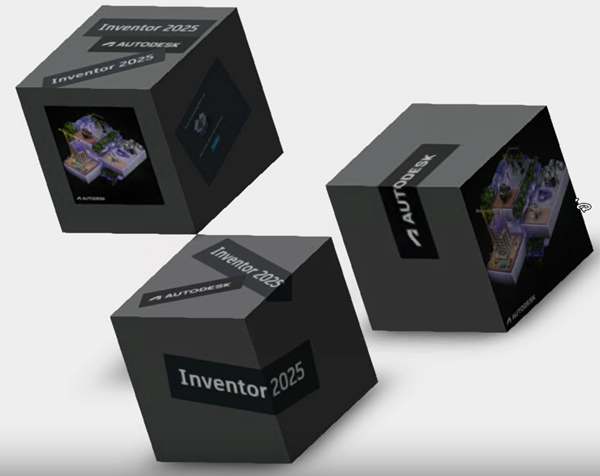

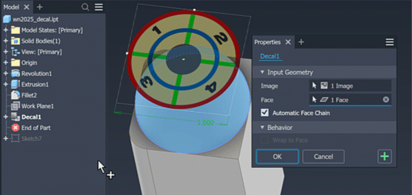

Decals
- Multiple decals can be placed on the same face. Their order in the model browser dictates which decal lies on top.
- Appearance overrides do not affect the decal appearance.
- Display on solids, surfaces, and derived parts and assemblies.
For more information, see About Embossing and Decals.
Shared Views
Shared Views now support decals, including multiple, overlapping decals on a single face. When creating shared views, the decal images are converted to SVF images for compatibility with viewers.
