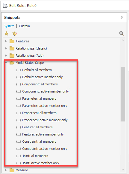

iLogic Support for Control of the Edit Scope with Model States
Use the snippets to control editing for Model States.

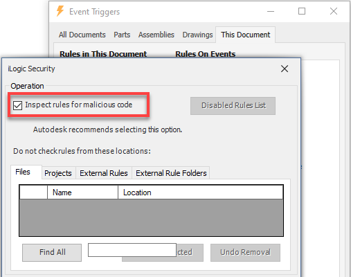

Enable iLogic security scanning of rules by default
The "Inspect rules for malicious code" option is now checked by default after the installation. This option can be accessed from either of the following:
- Event Triggers dialog > Options
- Tools tab > iLogic > iLogic Configuration > Security Options
