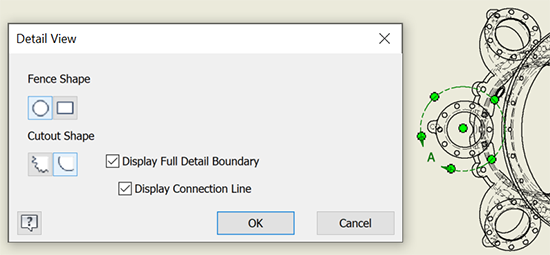

Detail Views
The most recent Detail View settings are used to populate the dialog for the next use.
Retained settings include:
  • Fence shape
  • Display full detail boundary, disabled for jagged boundary
  • Display connection line, disabled for jagged boundary

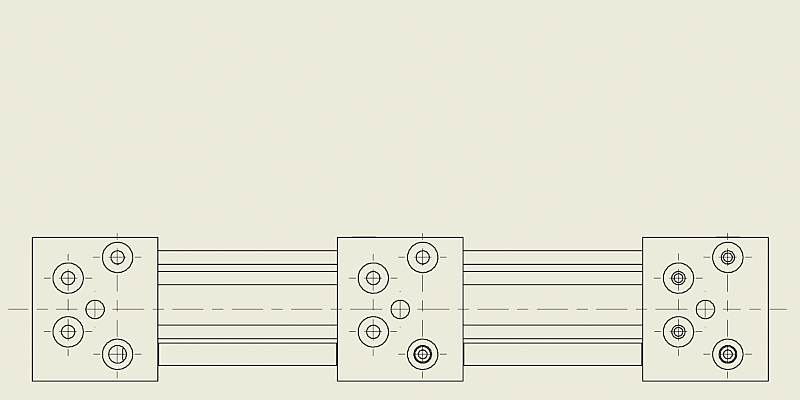

Annotations: Ordinate Sets, Baseline Sets, and Chain Sets
The dimension Sets (Ordinate, Baseline, Chain) workflow is improved, click Continue to place the set, then continue selecting members or use Esc to end the command. Use ESC to end selection when adding set members. Each member added is recorded in the Undo list.

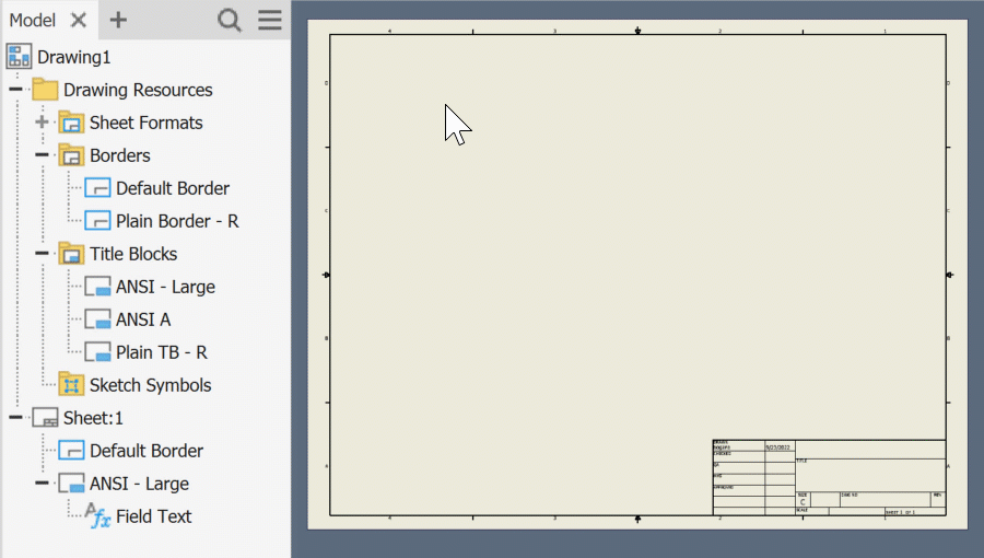

Drawing Resources
Easily replace the current title block or border using Insert in the replacement title block or border context menu.

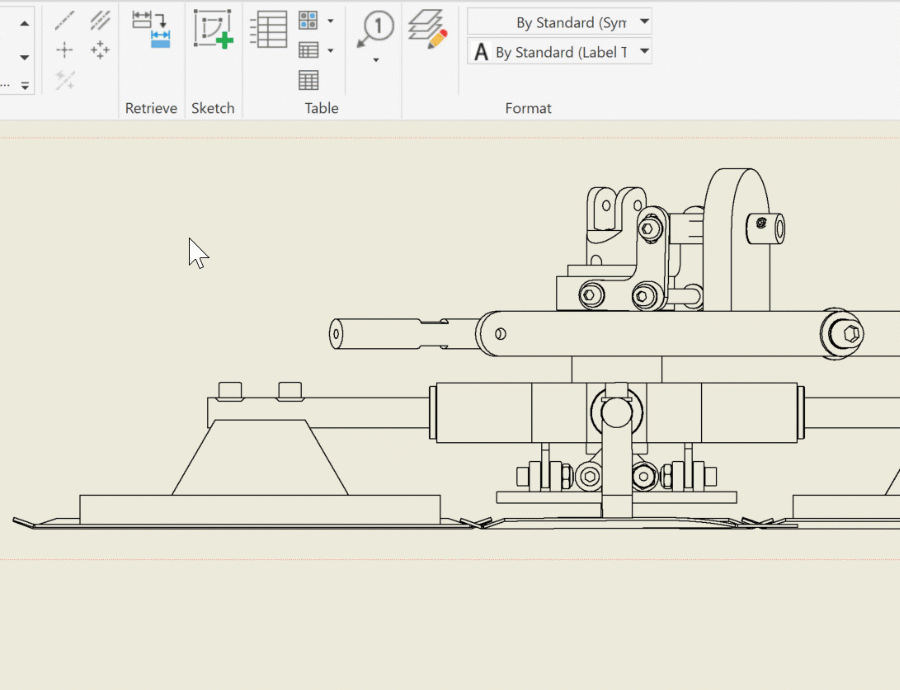

3D Model Annotations in Drawing Views
The 3D model annotations applied to parts can be retrieved in assembly drawing views.

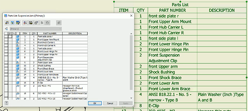

Parts List Editing and Navigation
The Parts List dialog is now a modeless dialog. That means, you can pan and zoom in the drawing while working in the dialog. If you use pan or zoom, use ESC to exit either without closing the dialog.
An Inventor® Ideas submission
