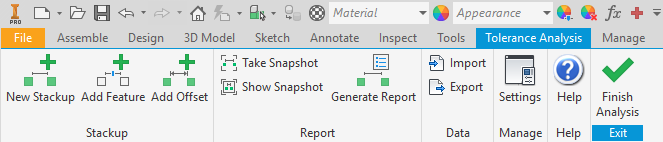

To Define Tolerance Analysis Settings
Click Tolerance Analysis on the Environments tab to enter the Tolerance Analysis environment. On the Tolerance Analysis tab, Manage panel, click Settings to open the dialog box, and specify the appropriate Default Tolerances.
