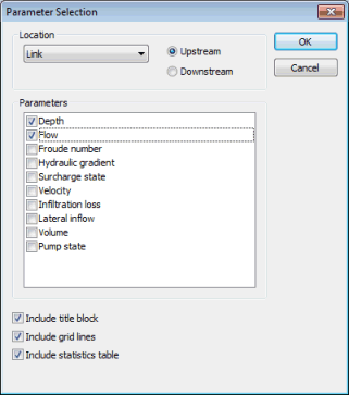

- Click Produce Graphs. This displays the Parameter Selection dialog.
- In the Parameter Selection dialog, select the type of location to view and the parameters to be graphed (up to three parameters may be selected at a time). For multiple locations, when plotting Link results, select whether to display results from the Upstream or Downstream end. Select other items to be included on the graph view from the bottom of the dialog e.g. title block, grid lines etc.
- Click OK to view the graphs.

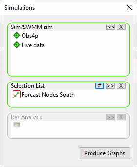

Simulation report
This simulation report allows graphing of results from one or more simulations. The report includes one page for each selected location.
To create a single or a multiple simulation report:
- Select Graph
Simulation report from the
Results menu. This displays the
Simulations dialog.
- In the Simulations dialog define one or more simulations for which results are to be graphed and either a Selection list or Results analysis to specify the objects (locations) to be graphed:
- Sim/SWMM sim - drag and drop one or several simulations of the same type from the Explorer window.
Selection List - drag and drop a saved
Selection list or click the Current button (
) to include all objects currently selected in the GeoPlan window.
Results Analysis - drag and drop a saved
Results analysis item or click the Current button (
) to include all
Results analysis points currently displayed on the GeoPlan Window.

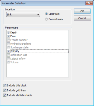

- In the Parameter Selection dialog, select the type of location to view and the parameters to be graphed (up to three parameters may be selected at a time). For multiple simulations, when plotting Link results, select whether to display results from the Upstream or Downstream end. Select other items to be included on the graph view from the bottom of the dialog e.g. title block, grid lines etc.
Tip: If only one simulation is specified in the Sim/SWMM sim box of the Simulations dialog, additional data - rainfall, ground level and flood level for nodes and rainfall and soffit level for links - can be graphed and specified on the Parameter Selection dialog. - Click OK to view the graphs.
