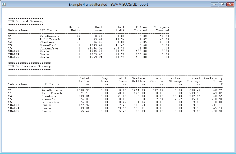

If the InfoWorks network includes SUDS control objects in a subcatchment, then control and performance summaries of their associated SUDS/LID structures during a simulation can be viewed in a SWMM SUDS/LID report. Any errors related to SWMM5 will also be included in the report.

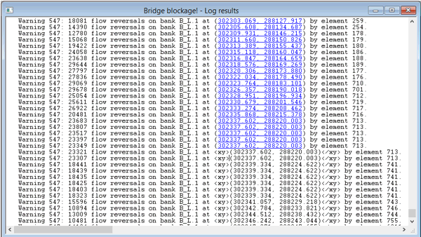

If you do not cancel the loading operation and the log file does not contain any coordinate based warnings, the log results will be opened in the Text File view.
However, if you do not cancel the loading operation and the log file contains any coordinate based warnings, then after the logging information has been loaded, InfoWorks ICM will then format the X,Y coordinate references as hyperlinks. A formatting progress window will initially be displayed, which can be used to cancel the formatting operation if required.

- Click OK. The Text File view is now displayed. The X,Y coordinates, which had been formatted before the process was cancelled, appear as hyperlinks. Unformatted coordinates will be displayed as text enclosed by <xy> and </xy> HML tags.
Example
If you do not cancel the formatting operation, the log results with hyperlinked coordinates will be opened in the Text File view.
To view a SWMM SUDS/LID summary report for an InfoWorks network:
- In the Explorer Window, right-click on the simulation object and select Open As from the popup menu.
- Select SWMM SUDS/LID report (text) from the Select Results dialog.

The report contains the LID Control Summary and the LID Performance Summary as well as any SWMM5 related errors such as such as:
ERROR 187: LID area exceeds total area for Subcatchment SWALE3.
Example
The information in the Text File view can be saved as a text file by right-clicking and then selecting Export To file. Choose a directory, enter a filename and click Save.
