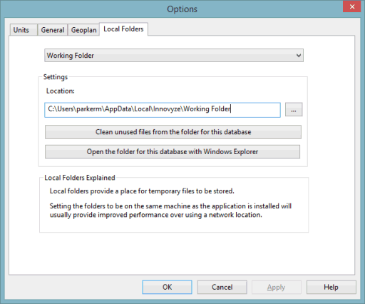

The Local Folders page on the Options dialog allows the locations of directories where local copies of data are to be stored to be set. The dialog is displayed by selecting Options from the Tools menu.
The options currently available are:
- Folder dropdown - select the option to which settings are to be applied:
- Working Folder - folder used to store working copies of database files.
- Results Folder - folder used to store local results files.
- Settings
- use this section to view or edit the location of the folder selected in the folder dropdown, or to clean the selected folder:
- Location - select the path of the directory to which working files for the current database will be stored.
- Clean unused files from the folder for this database - removes files from selected folder, except copies of networks with changes that have not yet been committed, and current results files.
- Open the folder for this database with Windows Explorer - opens the selected folder in a Windows Explorer view.
If the selected Location contains the current database, the Clean unused files from the folder for this database and the Open the folder for this database with Windows Explorer buttons are disabled. This is to prevent the current database from possibly being damaged, for example, by the removal of files. A message is also displayed when you click OK or Apply to inform you that the current database is stored in the selected Location.
