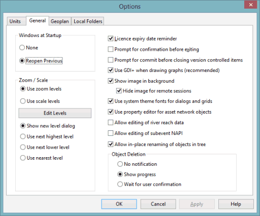

The General tab on the Options dialog allows a number of features that apply across the whole program to be changed. The dialog is displayed when you select Options from the Tools menu.
Options dialog - General page
The options currently available on this tab are described in the following table.
Option Description
Windows at Startup
Select the option to be used for reopening windows at start up:
  • None - do not open any windows on start up.
  • Reopen Previous - on start up, reopen the windows that were open when the application was last closed.
When using the Reopen Previous option, hold down the SHIFT key when starting the application to prevent reopening of windows.
Zoom / Scale
Use this section to indicate whether zoom levels or scales are to be used to control visibility (e.g. visibility of themes or auto-labels).
  • Use zoom levels - select to use zoom levels. Zoom levels are a function of the shape and size of the GeoPlan.
  • Use scale levels - select to use scale levels. Scale levels are a function of the drawn objects.
  • Note: If the type of level to be used is changed, the software needs to be restarted for the changes to take effect.
  • Edit Levels - click to edit the current levels. This displays the Scale or Zoom dialog (depending if zoom or scale is being used) where new levels can be added and existing levels can be deleted.
  • The buttons below are used to set the behaviour whenever a user types a new scale/zoom level value in a visible range or scale / zoom min and scale / zoom max box:
    • Show new level dialog - the New Level dialog gets displayed so that the user can add new levels to the existing set of levels.
    • Use next highest level - the existing level that is the closest to the typed-in value, but higher, will be picked by the software.
    • Use next lower level - the existing level that is the closest to the typed-in value, but lower, will be picked by the software.
Licence expiry date reminder
If checked, a warning message is displayed when your licence is within one month of its expiry date. See InfoWorks ICM Licences. Checked by default.
Prompt for confirmation before exiting
If checked, an "Are You Sure?" message is displayed when you close InfoWorks ICM.
Prompt for commit before closing version controlled items
Disabled by default
If checked, a message is displayed prompting you to commit your changes when:
  • Closing a locally modified version controlled item.
  • Closing InfoWorks ICM whilst there are one or more locally modified version controlled items for the currently selected database.
When the prompt is displayed, select Yes to proceed (the Commit Changes dialog is displayed), No to close the version-controlled item or InfoWorks ICM without committing any changes, or Cancel to abort.
Use GDI+ when drawing graphs (recommended)
Checked by default. High performance graphics may cause problems when printing graphs using GDI+.
Uncheck this box to turn off the use of GDI+.
Note: Non-solid lines on graphs cannot be used when GDI+ is turned off.
Show image in background
Checked by default. Uncheck to hide the image that is displayed by default in the InfoWorks ICM background.
  • Hide image for remote sessions - checked by default. The background image can slow down remote desktop sessions; select this option to hide the image when the session is remote.
Use system theme fonts for dialogs and grids If checked, the fonts defined in the system theme will be used for dialogs, property sheets and grids.
Use property editor for asset network objects
Checked by default. Property Sheets for asset networks will be displayed in the property editor of the Object Properties Window (modeless window).
Uncheck this box to display property sheets as a modal sheet with pages or tabs.
Allow editing of river reach data
Unchecked by default.
If checked, the editing of river reach data, such as river section and river bank parameters, is enabled. See River Reach Data Fields for more details.
Note: If you allow river reach data to be edited, be aware that the edited data is at risk of being overwritten if the river reach is re-built or updated.
Allow editing of subevent NAPI
If unchecked (recommended), New PR API30 (NAPI) values are only editable for the first subevent in a rainfall event.
InfoWorks ICM reads the values from the first subevent and calculates subsequent values of NAPI during simulation.
Check this option to allow editing of NAPI values for all subevents.
Note that in order to use the specified values to override calculated values during a simulation, it is necessary to check the Read subevent NAPI (New UK Method option on the Schedule Hydraulic Run View.
Allow in-place renaming of objects in tree
Checked by default.
If unchecked, in-place renaming of objects is disabled in the Explorer Window tree view.
Note: InfoWorks ICM (or the Explorer Window) may need to be closed and re-opened for changes to take effect.
To rename a object in-place, simply click on it on the tree. It becomes highlighted (in blue) and a box should appear surrounding its name. Rename the object as desired and either press the ENTER key or click outside the surrounding box.
Object Deletion
Determines deletion notification:
  • No notification - the objects selected for deletion are immediately deleted, without the user being notified.
  • Show progress - (default option). A progress dialog is displayed for a minimum of 1.5s, showing the deletion progress. To cancel deletion, press ESC whilst the dialog is being displayed.
  • Wait for user confirmation - you are required to confirm object deletion.
  • All users must confirm - only available to database owners. When set, this option overrides any of the above-mentioned settings. It is similar to the Wait for user confirmation option, except that it can only be set by a database owner and that it applies to all the database users.
Click OK (this saves the changes and closes the dialog) or Apply (this saves the changes but does not close the dialog) to commit the changes.
