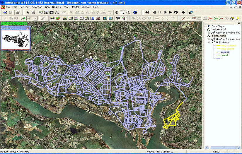

Network models can be used to assess whether there is any need for wide scale restrictions, and if so, the total extent of water use reduction that will maintain an adequate system performance and keep sufficient water in storage for essential purposes and emergency conditions.
Using an InfoWorks WS network model to identify supply deficiencies
The model can then be used to identify priority areas for continued supply and areas where water usage restrictions should apply. For example, reducing non-essential water usage such as leisure activities could help maintain essential services such as medical and public health uses. Using a detailed model with accurate and comprehensive demand modelling can help enormously. If the model is linked to billing databases and the demand allocation is at a property level in the model then detailed analysis can be undertaken of the impact of reducing supply to individual customers or groups with similar usage. If the model has a simplified demand allocation then the use in this area may be limited to generalisation and assumption, which may prove inadequate and ultimately unacceptable. Clearly, the more comprehensive and detailed your network model, the greater the potential benefit and the accuracy of decisions based upon it.
