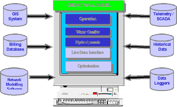

A number of software providers will claim to have “seamless” links to other systems, some will even claim to have models in the control room already, but are these systems really as good as their claims, and are they one off bespoke applications or transferable “off the shelf” technology that can affordably be used elsewhere?
Operational Modelling – Linking Business Systems
One of the problems of course is that GIS, SCADA, Telemetry, Asset Management and Billing systems will generally have been purchased by different parts of the organisation, and often the last consideration was “will this system readily link to all the others that we have or may conceivably purchase?”. Does it meet my requirements and budget? is the usual criteria. This means that either the modelling software has to be flexible enough to receive input from these various sources, or some intermediate files are required as a central repository for the data. There is no one size fits all solution.
Another important factor is the strength of the modelling engine, and its ability to model accurately complex operational controls (Programmable Logic Controllers in particular) and real pumps and valves. An operational model has to be just that, operational. It is not good enough to produce modelling fixes that may have been acceptable for initial model calibration. The Operator has to be sure that the model is truly representative under all conditions, otherwise there will be an uncertainty in their mind that at best will result in them losing confidence in the model and at worst could cause a serious breakdown in the system affecting a potentially large number of customers. This is where many current modelling packages fall down. Buyers beware; operational models simply must model the reality.
My advice would be to talk to a number of software vendors, ask them to prove that their system can integrate effectively with the other relevant systems, and test the capability of the model to accurately represent the most complex controls currently in the system (make some up if you are not sure).
