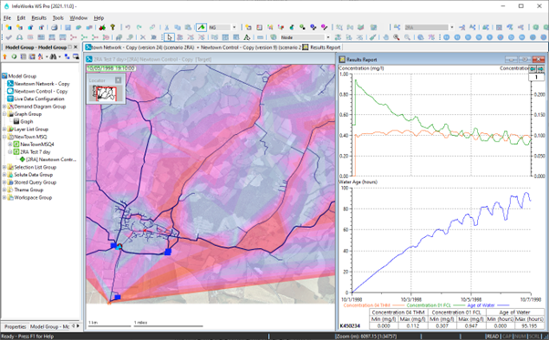

System models routinely set up in software such as EPANET and InfoWorks WS Pro compute the progression of water "parcels" through pipe networks over time. These system models can simultaneously compute chlorine concentration in each parcel from the processes that decrease it, as the parcels travel through the system. Similarly, THM concentrations can be computed from a THM formation process model. Figure 1 shows a seven-day simulation of chlorine and THM concentrations within a water distribution network in InfoWorks WS Pro.
Figure 1 - Example projection of chlorine decay and THM concentrations over a 7-day period
Embedding such process models in system models (in software such as Autodesk's InfoWorks WS Pro) provides the simulation tools needed to determine which alternative dosing strategies are effective, firstly for a "worst case" demand/flow/temperature scenario. However, to be credible and usable, the process models must be both accurate and computationally efficient.

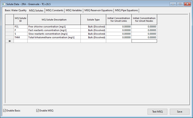

Figure 2: MSQ Solutes tab defining the four solutes considered within the water quality model
If there is a single water source, only one set of five constant coefficients applies, from primary dose to system extremities – two initial reactant concentrations (F0 and S0), two reaction rate coefficients at 20°C (KF20 and KS20), and one coefficient (EOR) to define the strength of the effect of temperature on rate coefficients around the reference temperature of 20°C. The first two coefficients must be set as fixed concentrations at the source. The last three of these coefficients are defined in the first three lines of Table 1. These five coefficients must be estimated from suitably designed laboratory decay-tests because their values are so different in different waters. The coefficients used in this paper were derived from decay tests on water from Greenvale, Australia, as described in the next section. Both the decay-test data and the predictions obtained from the PSO model using these coefficients are shown in Figure 6.

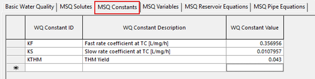

The five model coefficient values for the 2RA model are specific to a particular source water and must be determined from laboratory decay tests on that water. The first three (KF20, KS20 and EOR) are set in the first three lines above. The remaining two coefficients (initial concentrations of fast and slow reactants, F0 and S0) must be set as fixed concentrations at the source. The final three (KF, KS, and KTHM) are input in the MSQ Constant table shown in Figure 3.
The additional coefficient (KTHM) is required for the simulation of THM concentrations, which must also be derived from laboratory analysis of samples taken in conjunction with the 2RA decay-tests, as it is also specific to a given water. The value used here is the average from Satahsivan et al. (2020).
Figure 3 MSQ Constant tab showing the values applied to the model from Table 1

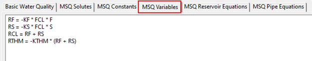

Figure 4 – MSQ Variables tab showing the equations for rate of change terms

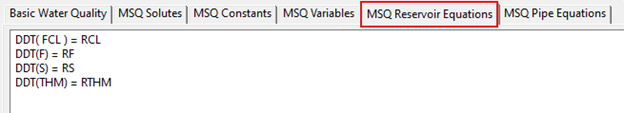

Figure 5 – MSQ Reservoir and Pipe Equations (both tabs use the same equations)

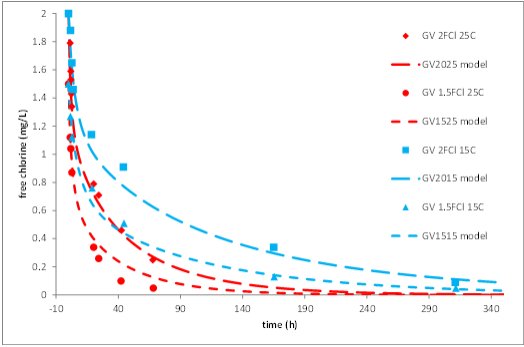

Derivation of the constant coefficients in the PSO/2RA chlorine-reaction model
As there is a wide range of types and concentrations of chlorine-reactable substances even in treated waters, the coefficient values that characterise a particular water can only be derived from decay tests. These tests should be conducted on a water sample taken after the filters, but upstream of the primary chlorine-dosing point, to ensure maximum comparability between the initial reactant concentration in decay tests and in post-filter water at the treatment plant.
To derive robust estimates of the coefficient values for one water, decay tests must be conducted for combinations of a minimum of two different initial chlorine concentrations (ICCs) and two different temperatures; i.e., at least four decay tests. The tests should run over a period of greatest in-system water age, and temperature should be controlled within 1°C. The test conditions should be chosen to encompass the operating range of ICCs and temperatures in the system of interest. Figure 6 below shows an illustration of measured data for the four recommended test cases.
Figure 6 – Chlorine decay in Greenvale water: markers - measured chlorine values; curves –values simulated by two-reactant model with temperature-dependent decay coefficient (model fitted to data from Fisher et al. 2012).
If booster dosing is used in the system, then a duplicate of the high-dose, high-temperature decay test should be followed by a booster dose and subsequent measurement of chlorine decrease. As well as providing a validation, it also ensures that the overall chlorine reacted in the tests exceeds that in the system.

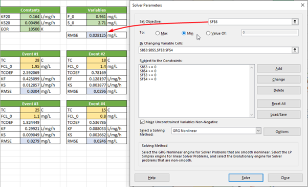

The coefficient values can then be determined from the decay-tests by using parameter-optimisation software such as Solver in Microsoft Excel. Such software systematically searches for the coefficient values which minimise the sum of squared differences between each data point in a decay test and the corresponding chlorine concentration predicted from the chlorine-reaction model. Figure 7 shows a sample screenshot in Excel of the Solver tool being used to minimize the calculated RMSE between model and measured data by varying KF20, KS20, the initial concentrations of the fast and slow reactants in the source water, and the EOR value.
Figure 7 - Screenshot of Excel Solver to minimize calculated error between model and measured data by varying KF20, KS20, F_O, S_O, and EOR
The model predictions are most efficiently generated by using the approximate analytical solution for the PSO developed by Kopaei and Sathasivan (2011). Alternatively, a numerical integration solution for the PSO can be set up within Excel, but including booster doses is difficult in either of these methods. We have generally used AQUASIM (Reichert 1994) for this reason and because it was specifically designed for convenient simulation of chemical reactions and parameter optimisation in batch samples and flow systems.

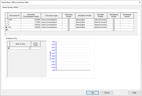

Once derived from lab tests using Solver or AQUASIM to fit the data, the initial concentrations (F0 and S0) can be applied to each water source in the InfoWorks WS Pro model directly at fixed head nodes and/or transfer nodes. Figure 8 shows a sample setup at a fixed head source from the treatment plant where fixed concentrations are applied for free chlorine, THM, and the fast and slow reactants.
Figure 8 – Concentrations of Chlorine, THM, and reactants applied as fixed values at fixed head node

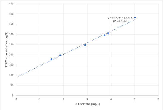

Derivation of the THM yield for use with the PSO/2RA model
Across a wide range of US and Australian waters with quality in the operating range of pH (7-8.2) and Br concentration (<200 μg/L), the THM yield [mg-THM/mg-chlorine consumed] was recently found to be fairly similar (Sathasivan et al. 2020). The average yield and standard deviation were respectively 0.043 and 0.008 mg-THM/mg-Cl. For an initial prediction of THM concentrations within a system, this average yield could be used in the MSQ module without the need for any sampling or chemical analysis for THMs. This default value has been used in the MSQ Constants tab (Table 1).
To develop a more accurate yield for an individual source, total THM [TTHM] concentration can be measured in a (quenched) sample, which is withdrawn from water undergoing a chlorine decay test. The corresponding chlorine concentration [Cl] is also measured immediately before quenching. If this is done at times 1 and 2, then
Yield = [TTHM2-TTHM1]/[Cl1-Cl2]
Samples should be quenched with sodium thiosulphate at the time of sampling to rapidly reduce chlorine to zero and so prevent any further THM formation before analysis. This procedure should be repeated to obtain at least three points to confirm linearity on a plot of TTHM vs. Cl consumed. One of these points should be derived for the greatest amount of chlorine consumption – at the end of the rechlorination decay-test. If booster chlorination occurs between times 1 and 2, then the net increase in chlorine due to each boost must be added to the denominator of the yield equation to calculate the total chlorine consumed in that time period.
The slope of a linear regression on these points gives the best estimate of the yield to use in MSQ. The intercept (on the TTHM axis) should be almost zero if the long-term proportionality between TTHMs and Cl consumed built into the TTHM model is valid. A substantial positive intercept (as shown for a real water in Figure 9) indicates that some treatment process has generated TTHMs before the filters (e.g., pre-chlorination) and the initial TTHM concentration must be set accordingly in the InfoWorks model at the fixed head source. A substantial negative intercept indicates that "non-productive" reactions occur soon after initial dosing, which can be represented with a simple modification of the fast reaction in the PSO model (Sathasivan et al. 2020).
Figure 9 - Total THM (TTHM) formation resulting from corresponding chlorine demand in Hervey Bay filtered water. Note the regression does not pass through the origin because pre-chlorination at the WTP resulted in 90 ug/L TTHMs before decay tests were conducted. Data from Fisher et al. (2021).
