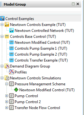

Groups and items can be accessed and manipulated using a tree view.
  • The InfoWorks WS Pro Explorer is a normal view that displays all the information about groups and items in the database.
  • The Model Group window only displays the tree, but can be docked at the side of the main InfoWorks WS Pro window so it is always visible.
Show image
