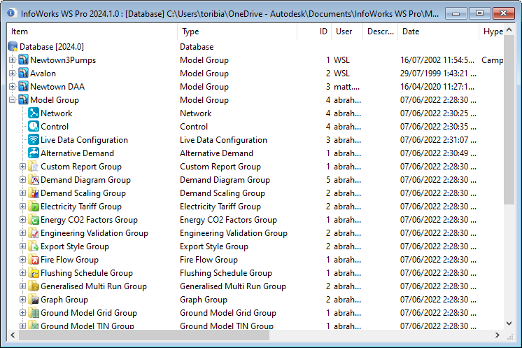

The Explorer window is a hierarchical representation of the data associated with a database. The Explorer window provides a range of facilities to manage the database.
The Explorer window is opened by selecting Window New Explorer window.
The Explorer window displays a tree representing the database.
  • To open or close a group in the tree, click the or symbols to the left of the group name, or double-click the group name.
  • To perform a task on an item in the tree, click the item and select an option from the product menus, or right-click the item and select an option from the context menu.
For a full description of the meaning of the different icons displayed in the tree, see Database objects list.

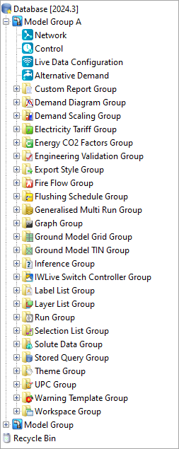

Tree view
Database objects are displayed in a hierarchical tree view:
  • To perform a task on an object in the tree, click the item and select an option from the product menus, or right-click the item and select an option from the context menu.
  • Hover the mouse cursor over the object in the tree view to display a tooltip listing the item's details
Note: A network, control, or run icon in a Reserved status will be overlayed with an orange border in the tree view (e.g. ) when working in a cloud database.
For details on working with items in the tree, see the Working with database objects.
