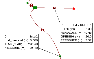

Summary results can be displayed for one or more network objects using labels on the GeoPlan window or the object information area of the Long Section window. These display constantly changing results as the simulation is replayed. You can also freeze the simulation at a timestep to view snapshot results.

GeoPlan labels showing results for a node and a valve
For full details on using configurable labels on the GeoPlan window, see Working with GeoPlan labels.
