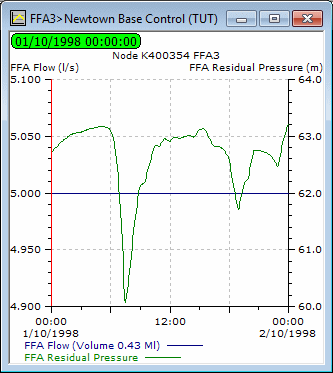

Graphs for individual nodes
To view a graph at an individual node, follow the instructions for Graphing data for a network object.
There are two additional results fields when viewing fire flow simulation results:
  • FFA Flow - The maintained fire flow.
  • FFA Residual Pressure - The residual pressure after the fire flow is taken into account.
You can also view the same results on a grid.

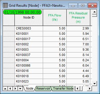

Node results grids
You can view results on grid views while replaying a simulation.
The Node grid view in the Nodes grid includes the FFA Flow and FFA Residual Pressure results fields. These are time varying fields and you can see the values changing during the replay.
Node grid view (results version)
