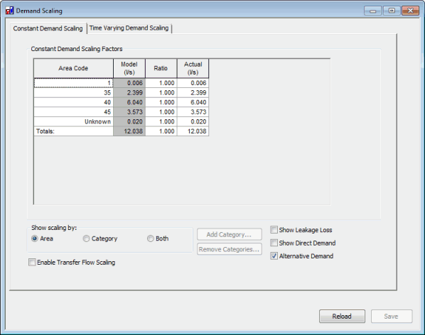

Area Code
To display demand scaling by Area Code, select the Area option from the Show scaling by: section.
The Area Code of a node is defined in the Node Definition Page of the Node Property Sheet.
All node area codes in the network are displayed in the Area Code column of the Demand Scaling Grid. Demand on nodes without an area code is grouped in the "Unknown" area code row.
If the Enable Transfer Flow Scaling option is checked, flows assigned to Transfer Nodes will be included in the Demand Scaling Grid, and scaling factors will be applied to the transfer node profiles during simulation.
The Area Code column is read-only. The list is maintained by InfoWorks WS. To update the list (and model demand values) with changes in the network, use the Reload button.

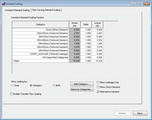

Demand Category
To display demand scaling by Demand Category, select the Category option from the Show scaling by: section.
Zero or more demand categories can be displayed in the Demand Scaling Grid. To add a demand category a Demand Diagram must be open.
  • To add a demand category: click the Add Category button, or right click in the grid and select Add Demand Category from the context menu. The Select Demand Category dialog will be displayed. Select the type of demand category to be added and then select a category name from the dropdown list. The dropdown list will contain all demand categories of the selected type that are in the Current Demand Diagram and have not already been added to the Demand Scaling Grid. Alternatively, click the All Categories button on the Select Demand Category dialog to add all demand categories in the Current Demand Diagram to the Demand Scaling Editor.
  • To remove a demand category: click the Remove Category button. The Choose Category to Remove dialog will be displayed. Select the category to be removed from the dropdown list and click OK. Alternatively, right click in the grid on the row of the category to be removed and select Remove Category <category name> from the context menu.
Demand in categories not added to the grid is grouped in the "All Unspecified Categories" category row.
If the Enable Transfer Flow Scaling option is checked, a Transfer Flows category will be added to the Demand Scaling Grid, and scaling factors will be applied to the transfer node profiles during simulation.

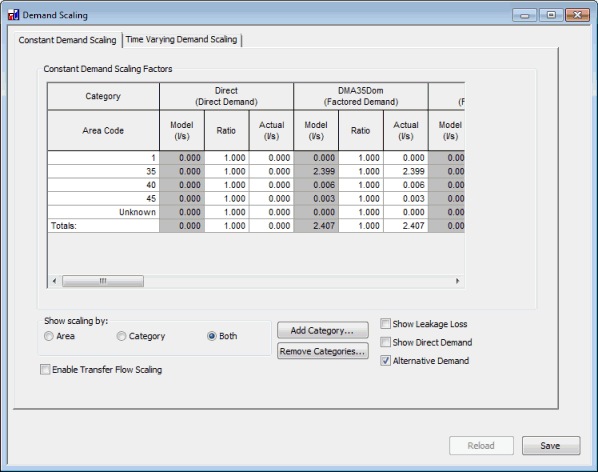

Both
To display demand scaling by both Area Code and Demand Category, select the Both option from the Show scaling by: section.
Demand is displayed by both Area Code and Demand Category.
  • All node area codes in the network are displayed in the Demand Scaling Grid. Demand on nodes without an area code is grouped in the "Unknown" area code row.
  • Zero or more demand categories can be added to the grid. (See Category section above for details of adding and removing demand categories.) Demand in categories not added to the grid is grouped in the "All Unspecified Categories" section.
  • If the Enable Transfer Flow Scaling option is checked, a Transfer Flows category will be added to the Demand Scaling Grid, and scaling factors will be applied to the transfer node profiles during simulation.

Show scaling by:
Select an option for display of scaling factor grid:
  • Area - display demand scaling by Area Code
  • Category - display demand scaling by demand category
  • Both - display demand scaling by both area code and demand category
Constant Demand Scaling Factors grid
Grid used to enter constant scaling factors between model and actual demands.
Either the Ratio or Actual fields can be edited. The other field will be updated automatically.
Column Description
Category
Displayed when Show scaling by: is set to Category or Both.
Demand Category as displayed on the Node Demand page of the node property sheet.
Area Code
Displayed when Show scaling by: is set to Area or Both.
Area Code as displayed on the Node Definition page of the node property sheet.
Nodes that do not have an area code set will be grouped in the Unknown area code row.
Model
Demand calculated from the model. This is the average demand allocated to the model before demand scaling takes place.
These values are read-only and are maintained by InfoWorks WS. To update the values (and the list of area codes if applicable), use the Reload button.
Ratio
The ratio of Model demand to Actual demand. If this value is edited, the Actual demand will be adjusted automatically.
Actual Demand after demand scaling has been applied. If this value is edited, the Ratio will be adjusted automatically.

Add Category button
Enabled when Show scaling by: is set to Category or Both
Click this button to add a demand category to the categories displayed in the demand scaling factors grid.
Clicking this button displays the Select Demand Category dialog:
The dropdown list on the dialog only contains categories that exist in the current Demand Diagram and that match the choices made in the other boxes on the dialog.
Click the All Categories button to add all of the categories in the current Demand Diagram to the Demand Scaling Editor.
Remove Categories button
Click this button to remove a demand scaling category from display in the demand scaling factors grid.
Clicking this button displays the Select Categories to Remove dialog:
Select categories from the list and click OK, or click All to remove all categories.

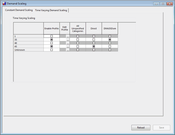

Time Varying Demand Scaling
The Time Varying Demand Scaling page is used to define time varying profiles of scaling factors to be applied to demands in the network.
Time varying scaling grid
Column Description
Area code
Enable Profile
Check this box to apply the time varying profile when running a simulation.
If the profile is not enabled for an area, all the other cells of the row will be disabled (greyed out).
Edit Profile
Click the Ellipsis button button to display the TV Demand Scaling Editor., where the profile may be viewed and / or edited.
Note:
Please note that only a single time varying scaling profile can be specified for an area.
Select a Profile type from the dropdown:
  • 24 Hour - enter a 24 hour scaling profile (HH:MM)
  • 7 Day - enter a 7 day scaling profile (Day, HH:MM)
  • Absolute - enter a scaling profile using absolute date/time (Date, HH:MM)
Demand in categories not added to the grid is grouped in the All Unspecified Categories column.
Check this box to apply the time varying profile to all unspecified categories at nodes with the area code shown in the first column.
To add categories to the grid use the Add Category button on the Constant Demand Scaling page of the editor.
Area Code columns
A column is displayed for each demand category added to the grid.
Check the box for a demand category to apply the time varying profile to that category for nodes with the area code shown in the first column.
