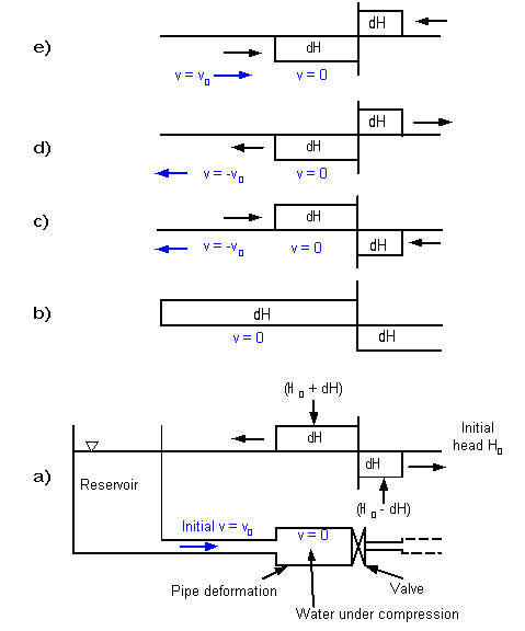

Consider the pipe upstream of a valve that has been instantaneously closed:
  1. As the valve is closed, the water adjacent to the valve is brought to rest with consequent compression of water upstream of the valve and expansion of the pipe cross section upstream of the valve. The increase in pressure at the valve causes the generation of a pressure wave with positive excess pressure head (ΔH) which is propagated upstream.
  2. The pressure wave reaches the reservoir.
  3. Water is forced backwards into the reservoir. Velocity in the pipe reverses and pressure drops back to static (reservoir pressure) again. The pressure wave is reversed and propagated back towards the closed valve.
  4. As the pressure wave reaches the closed valve, a low pressure region forms at the valve, destroying flow and generating a pressure reducing wave which is propagated towards the reservoir.
  5. Pressure reducing wave reaches the reservoir. Water flows from reservoir into pipe, velocity in pipe is reversed and a pressure generating wave is propagated towards the closed valve.
The cycle is repeated with the pressure oscillations being damped within a short period of time by friction.

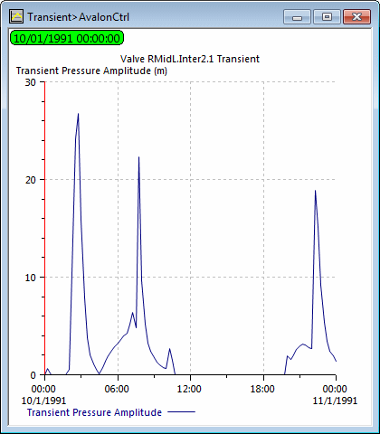

The transient advisor results can be displayed as for other results: in a grid report or as a graph of the time varying result for a single network object.

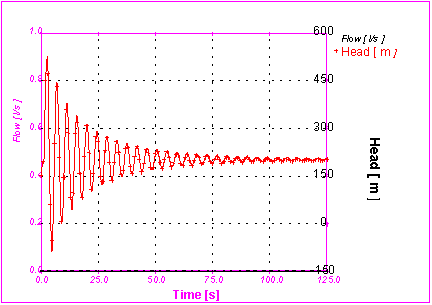

Transient pressure amplitude will be graphed as smooth continuous lines joining transient pressure values. Show image
In reality transient pressure changes occur over a very short time period (seconds). Show image
The smooth graph traces produced by InfoWorks WS Pro represent an approximate bounding envelope for the real, spiky transients.
