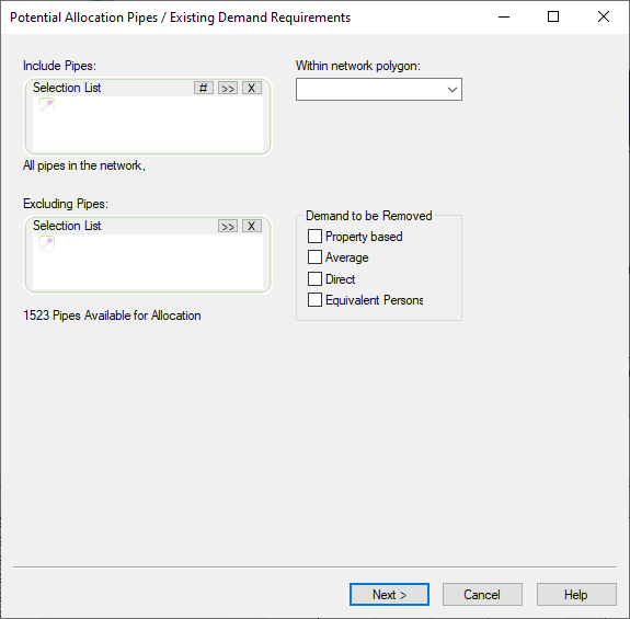

Static Demand Allocation wizard - Potential Allocation Pipes page
When this page of the Static Demand Allocation wizard opens, a progress bar entitled Scanning All Pipes in the Network may appear.
On the Review Data page there are options to select a subset of the customer point data, using a polygon and data flag to limit the customer points used for demand allocation.
On this page there are options to select a subset of pipes in the network to which the demand can be allocated.
Data field Description
Include Pipes Selection List
Limit the pipes to a specific set by including a selection. Either drag one or more selection lists into the box or browse for selection lists using the Browse button. Alternatively, select pipes in the GeoPlan window and click the Current button to choose current selection. An option will appear to include pipes between selected nodes.
If the Selection list box is left empty, InfoWorks will assume that all pipes are available for allocation.
Within Network Polygon
Limit the area in which pipes are included using a polygon. Both ends of the pipe must fall within the polygon for the pipe to be included
Excluding Pipes Selection List
Limit the pipes to a specific set by excluding a selection. Either drag one or more selection lists into the box or browse for selection lists using the Browse button.
Demand to be Removed
Options to remove existing demand at all pipes in the set that has been defined using the options above. If none of the options are selected, the allocation of all existing demand will be left unchanged. One or more options may be selected to remove any combination of:
  • Property based
  • Average
  • Direct
  • Equivalent Persons
None, some, or all of the above filtering processes may be carried out. So, you could:
  • limit the pipes geographically using a polygon
  • further limit the pipes by using a selection list of pipes to include all the pipes that are selected and fall within the polygon
  • reduce the list of pipes by excluding a selection list
Finally
Click Next to continue. A progress bar entitled Scanning All Pipes in the Network may appear.
The Allocate to Network page of the Static Demand Allocation wizard is displayed.
