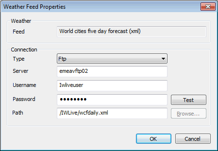

The Weather Feed Properties dialog is used to set the connection properties of the weather feed currently selected in the Weather Feed Configuration dialog or the IWLive Switch Controller dialog.
The dialog is displayed in the following cases:
Show image
Weather Feed
Read-only. This is the weather feed name.
Please refer to the Weather Feed Configuration dialog topic for a list of available feeds.
Connection Type
The options are:
  • File - select a file containing weather feed data
  • Ftp - enter connection details to ftp server
Server
Name of ftp server
Username
Username to log on to ftp server
Password
Enabled when connection Type is set to Ftp.
Password associated with the specified user
Path
Path to weather feed data (directory or file).
If referencing a directory location, the path must end in either a slash ('/') or backslash character ('\'), e.g. \IWLive\ or /IWLive/.
Test button
Click the Test button to test the connection to the specified ftp server.
Browse button
Enabled when connection Type is set to File.
Click the Browse button to display a standard file open dialog.
Select the file containing the weather feed data and click Open.
