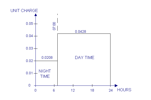

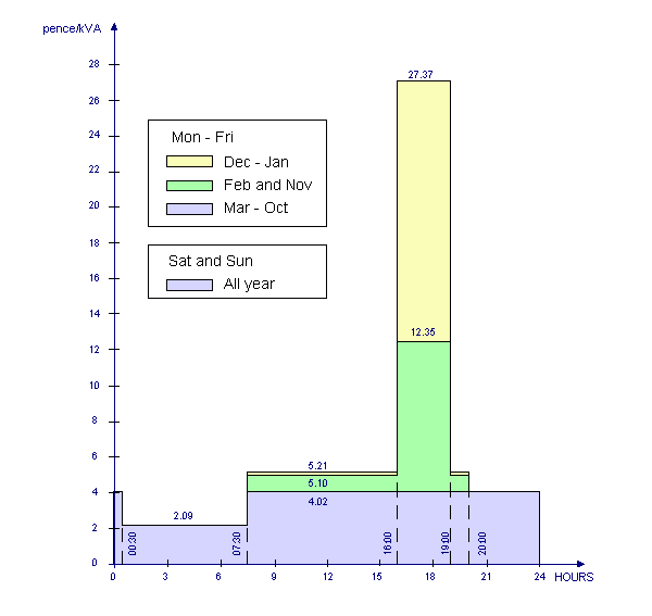

The figures below show seasonal changes of Maximum Demand Charge and changes of Unit Charge over a day of M2 tariff.
Seasonal Changes of Maximum Demand Charge (M2 example electricity tariff)
Daily Changes of Unit Charge (M2 example electricity tariff)
