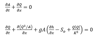

If the Use Time Dependent Equations (Open Channels) option is set to "Yes", the open channels are modelled using time-dependent St. Venants equations. Only one value of hydraulic roughness may be assigned which uses either Colebrook-White or Manning expressions for the conveyance. The governing equations are a pair of conservation equations for mass and momentum:
where:
Q - discharge or flow (m3/s)
A - cross-sectional area (m2)
g - acceleration due to gravity (m/s2)
h – water surface depth (m)
So - bed slope
K – conveyance
Each open channel is divided into discrete computational points regularly spaced at an interval of 20 times the channel diameter. The St Venants equations are then solved directly using a Preissman scheme and a finite difference formulation. The equations are discretised in the plane defined by the channel length and depth for water surface depth and flow and are completed with boundary conditions at the junctions with the upstream and downstream reservoirs. Inflow into the open channel is through an orifice and outflow at the bottom is either that for a broad-crested weir or, if no weir is defined, that corresponding to critical flow, calculated from the down-stream wetted area and flow width at the water surface. Open channels in InfoWorks WS Pro are allowed to spill if the water level is above the channel height at any point along the channel.
