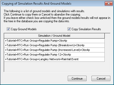

This dialog is displayed when copying between databases, where the items being copied include one or more of the following:
- Ground model
- Run including server based simulation results files in the remote results root
Because ground model and results files are potentially very large, you have the opportunity to exclude these files when making the copy.
When copying into a transportable database, data is compressed to make the most efficient use of space. This process can be time consuming and it may be quicker to ignore ground model and results files at this stage and import ground models or regenerate results files from runs when the data is needed.
The options available on this dialog are detailed in the following table:
| Option | Description |
| Copy Ground Models |
Available when at least one ground model is included in the item(s) being copied. Because ground model are potentially very large, the opportunity is given to ignore these files when making the copy. To ignore ground models, ensure the checkbox is unticked. |
| Copy Simulation Results |
Available when at least one simulation is included in the item(s) being copied. Because results files are potentially very large, you have the opportunity to ignore these files when making the copy. To ignore simulation results, ensure the checkbox is unticked. |
| Continue | Carry out the copying using the selected settings. |
| Cancel | Abort the copying operation. |
