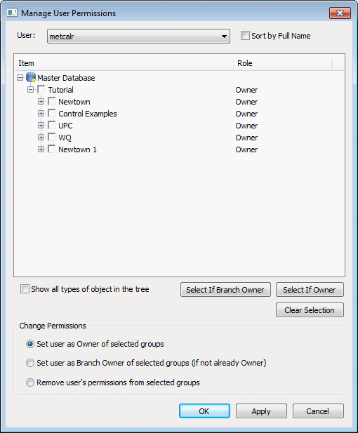

This dialog is used to view and set permissions of a selected user for multiple model groups within the database.
Alternatives:
- To view and set permissions on a selected model group for multiple users, use the Edit Owners dialog.
- To edit the list of database users, use the Users And Permissions dialog.
To display the Manage User Permissions dialog, right-click a model group in the Explorer window and select Manage user permissions from the context menu. This menu option is available only if user permissions are enabled and you are a database owner.
