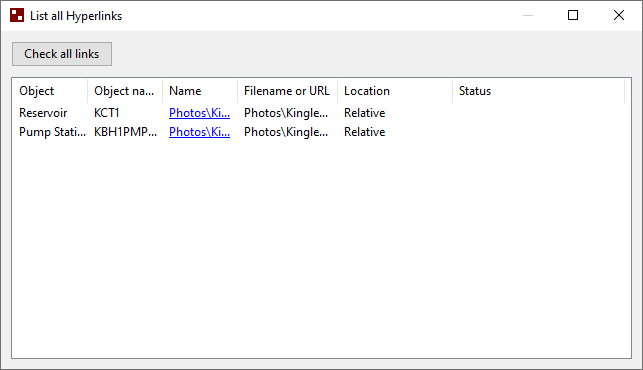

This dialog displays a list of all hyperlinks attached to objects in a network. You can check the hyperlinks and open the hyperlinked information.
To display the dialog, choose Network > List all hyperlinks from the Network menu.
| Item | Description |
| Check all links (button) | Click to check all the links. The results are shown in the Status column. |
| Object | The type of network object. |
| Object name | The name of the network object. |
| Name |
The name given to the hyperlink when it was added to the network object. This may still be the default name, which is the filename or URL of the destination object. You can click this name to open the hyperlinked information. |
| Filename or URL | The filename or URL of the destination object. |
| Location | For example, Locally mounted drive. |
| Status | Shows the results of clicking the Check all links button. |
