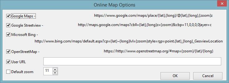

Online Map Options dialog
The Online Map Options dialog is used to select the online maps that can be used to view the GeoPlan. It is also possible to specify a user-defined URL.
The dialog is displayed when the Online Map Options button is clicked in the GeoPlan page of the Options dialog.
Show image
Online Map Options Dialog
Option Description
Online map selection
Select the desired web mapping services by ticking the check box adjacent to them.
These will appear as options when you select View online from the GeoPlan context menu.
Google Maps
Web mapping service application provided by Google™.
Google Street View
Technology featured in Google™Maps and Google™Earth that provides panoramic views from positions along many streets in the world.
Microsoft Bing
Web mapping service provided as a part of Microsoft™'s Bing suite of search engines.
OpenStreetMap
Collaborative project set up to create a free editable map of the world.
User URL
User-defined URL.
Tip:
Note that {long} {lat} and {zoom} must be specified in that order. See the example URLs given for the built-in online maps in the dialog itself.
Default zoom
Zoom in arbitrary units (0 to 20).
To specify a zoom level for all web maps, check the adjacent check box and select a value.
If this option is not enabled (i.e. unticked checkbox), the online map zoom level will match the GeoPlan current zoom level.
