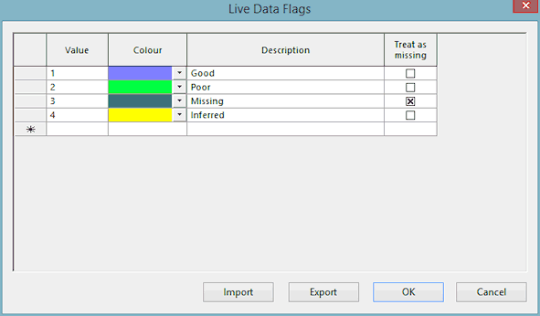

Learn how you can use this dialog as and administrator or as a user to manage live data flags.
This dialog has two uses:
- When accessed by an administrator using the Open
Database settings | Live data flags menu option, the dialog allows a set of default live data flags to be set up which will apply to all new live data configurations. If the database global settings are protected, only database owners will be able to make changes to the default live data flags. See
User Permissions.
- When accessed by other users, the dialog allows a set of live data flags to be set up for the current live data.
| Item | Menu |
| Value | Enter the flag number (as in the logger file). |
| Colour | Select the colour of the flag which will be displayed in graphs. |
| Description | Enter a description of what the flag indicates. |
| Treat as missing | Check this box to ignore data points with the current flag when graphing. |
| Import | Use to import flag information from a CSV file. Importing flag information will overwrite any existing flag information. |
| Export | Use to export existing flag information to a CSV file. |
