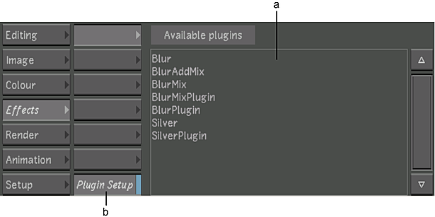

  1. Select a shot and scrub to the first frame.
    Click Effects, and then enable Plugin Setup.
    (a) Available plugins list  (b) Plugin Setup button  
    The Available plugins list appears.

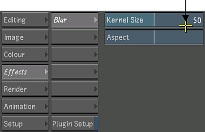

  2. Select Blur from the plugin list, and then set the kernel Size to 50.
