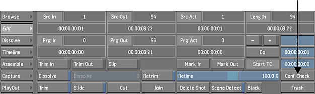

  4. Click Editing, and then click Edit to display the Edit menu.
  5. Drag the digital reference cut from the Library to the Confidence Check button.
    A split screen display appears. The current first frame is loaded in the left viewer and the digital cut is loaded in the right viewer with the first frame displayed.

    The confidence check reference is saved with the cut. When using a clip from the Library for a Confidence Check, the reference clip, its timing offset and the viewing mode (Single or Dual and Wipe position) are saved with the cut information. When reloading a cut, you do not need to manually reload the Confidence Check clip and set the proper offset value. Simply clicking the Conf Check button (located in the Editing/Edit menu) displays the confidence check view with the reference clip and the defined offset value.
