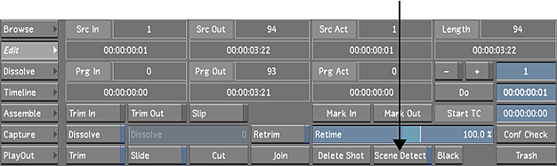

Click Editing, and then click Edit to display the Edit menu.
Enable Scene Detect.

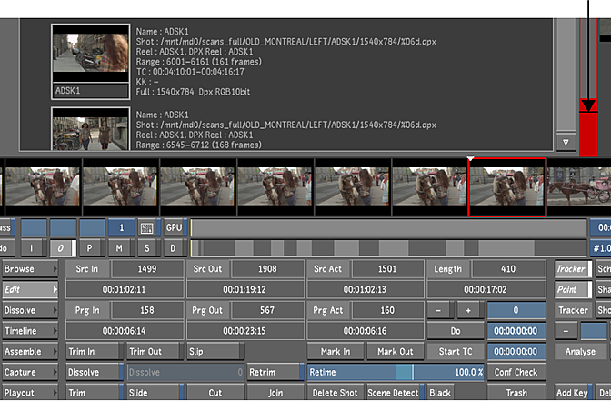

Tip:If the Editing While Grading button is enabled in the User settings, you can start a scene detection from any menu by pressing Shift+S. For more information about the Editing While Grading button, see System & Menu Settings.A threshold indicator bar appears to the right of the Library. When a scene change is detected, the indicator jumps and turns red, and a splice is introduced into the Storyboard, Timeline, and timebar at that frame. When the process is completed, a series of shots is created in the Storyboard.
You can change the threshold by dragging the thin black horizontal line in the threshold indicator up or down. When you lower the threshold value, a small amount of change is enough to trigger a splice. If the value is too low, splices appear in the middle of a scene. If the value is too high, some changes may not be detected. Generally, the default threshold value gives a good result.
