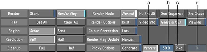

  4. In the Render Local menu, set the proxy size.
    Enable:To enter:
    PercentThe size of the proxy as a percentage in the Percent field.
    PixelThe width of the proxy in pixels in the Pixel field.
    (a) Percent button  (b) Percent field  (c) Pixel button  (d) Pixel field  
    Modifying a value in one field automatically updates the value in the other field.
    Note:No other options in the Render Local menu affect generated proxies.

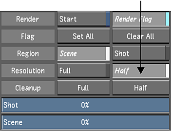

  1. Do one of the following:
    • Enable the Half Resolution button in the Render Local menu or in the Grade menu.
    • Set the Full/Half Resolution button to 1/2.
    • Press F9.
    Note:An ungenerated proxy appears as a red X with a black background.
